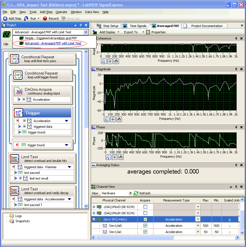

And after you have used the basic workspace to identify hit and response locations, I recommend that you switch to the Advanced work area to perform averaged FRF measurements.
19377iD3036B3E537BD43D
Please note, the shown FRF data is saved in the example project viewers. When you run the example, and start triggering impacts, your data and the correct number of averages will be shown in the Data View.
