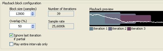

 I am a new user of the Signal Express / Sound And Vibration Measurement Suite user, and have some “small and easy” questions. Hope you can help me with it!! I have seen that when making a “Playback” of a recorded signal, I have the option of introducing an “overlap”, as on the attached picture:
 I want to know if I can do something similar when “Running” the Project or when visualizing the spectra “on real-time”. Maybe changing the value of this overlap to the range between 20% to 80%. How can I do this?, is it possible?

Unfortunately this operation mode is not available in recording mode. The reason is that this functionality is intended to be used for data analysis. You might be aware that overlapping is extremely useful in speech and sound analysis. However, you can still apply overlapping for monitoring your signal's spectral power. This can be done through the analysis step "Zoom Power Spectrum":
