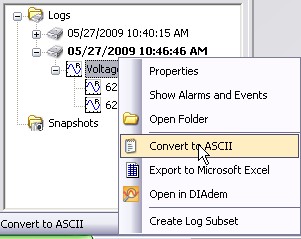

I attempted to recreate the behavior you are describing and could not reproduce it. I just want to make sure how you are performing the export. Are you right-clicking on the task name and choosing Convert to ASCII? What does the resulting log file look like?

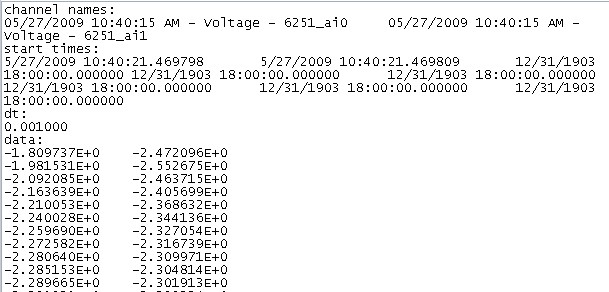

Yes, I am creating the ASCII file in the way that you describe.  (I've also created it automatically in the project's preferences)  It looks just like the ASCII log file should (like your example), but with only a single channel.  I've gotten this to work previously without any extra work, which compounds my confusion in this case.
