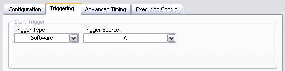

I tried configuring a software trigger over here and it seems to be working OK on my end. Which bar are you referring to, could you provide a screenshot? If I look in the Triggering Tab of my DAQmx Read configuration, the Software trigger remains configured as I left it:
Again, a screenshot or perhaps the SignalExpress project itself could be helpful, since I am not entirely sure of what the problem is you are experiencing.
