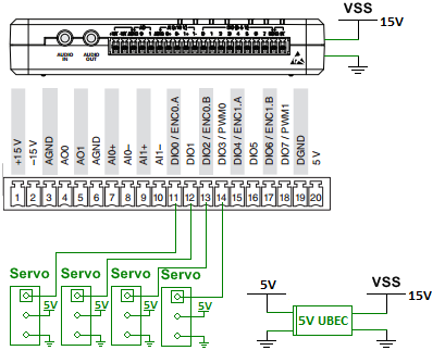

 Circuit.
For this project, no complex circuitry is required as all the motors require 5V; the motors are controlled by using the digital channels. Figure 4 shows below, that the myRIO 5V channel was not used, as the current that would be provided would not be high enough to power all the motors effectively. With the use of an UBEC and a separate power supply, enough power can be suppled to all the motors. UBEC is a 'switch mode' DC regulator that takes the high voltage (15V) from the power supply and converts it to a constant and safe 5V for the servos.
Wiring.PNGFigure 4. Wiring diagram.

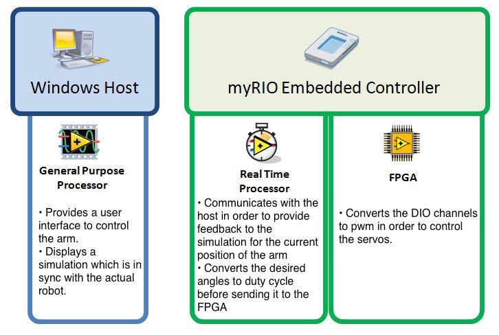

 Software.
Figure 5. myRoboLab software
In figure 5 above, you are able to see more details on what the host computer, Real-Time and FPGA targets are responsible for. With the use of LabVIEW, all three targets can be programmed following the same intuitive graphical programming approach, but let's take a closer look at the program.
