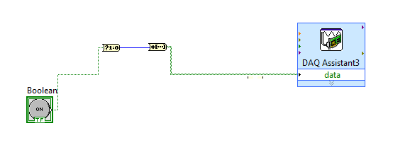

The DAQ expressed generated block expects a boolean 1D input. (See pict attached).
I want to hook up a boolean switch to drive relay line 0. You can not direct connect because the switch is boolean and the input is boolean 1D -- I do a conversation in the pict.
While probing the lines show the expected results, the relay never activates.
Any heap would be greatly appreciated! Thanks

I think the reason why this is failing is that the conversion you are doing generates an array of 16 booleans [as the "boolean to (0,1)" function creates a I16 datatype] with your data plus 15 false data points.

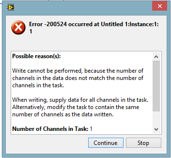

When you try to command the relay it sees 16 datapoints you are commanding to a single port [channel] and should error out.
My suggestion would be to use the normal DAQmx digital output vis [with it set up as "Digital>>Single Channel>>Single Sample>> Boolean (1 Line)"] instead of the DAQ assistant.
If you must use the daq assistant, simply using the "Build Array" function will turn your single boolean data point into an array of booleans with one element.

I am having another problem with the 6525. If I toggle the output line fast once a second, then I get the following error:
Error -201278 occurred at DAQ Assistant
Possible Reason(s):
Consecutive writes to a digital line occurred more frequently than the device can safely allow.
I replaced the solenoid with an LED (20ma current) and I get the same error.
