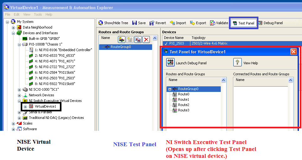

Or are you talking about the Test Panels that you open up within NI Switch Executive? The test panels for NI Switch Executive refer to the NI Switch Executive virtual device name, not the DAQmx device name. If you had named the NI Switch Executive Virtual device name in a similar manner, this could be part of the confusing problems that you are seeing. See images below:
NI DAQmx Test Panel Selection Brings this up.
NI Switch Executive test panel brings this up. If these device names are similar, I can see how this could be confusing.

Thanks for the explanations Frank.  Due to being a bit new to this, I admittedly don't understand it real well and as such I've mangled some of the explanations.  A colleague who does understand our setup, however, read your replies and he said your post above explains what we're seeing.  Thanks for the time you put into this.
