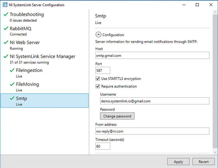

I agree that we could really use an option to send a test email.  I found it difficult to setup the first time as well.  Here are a few suggestions.
If you are using Gmail, you will need to disable 2 factor authorization.  With 2 factor disabled, these are the settings that worked for me.

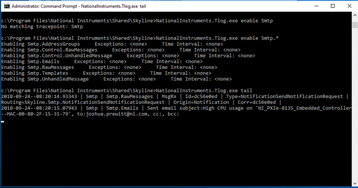

Also, you can see a little more information if you use Trace Logger on the server.  To do so, open a command prompt as Administrator on the server and navigate to c:\Program Files\National Instruments\Shared\Skyline.  Then run "NationalInstruments.Tlog.exe enable Smtp.*" followed by "NationalInstruments.Tlog.exe tail".
Here is what it looks like when everything is working.
Here is what it looks like when it isn't working.  In this case, I have 2 factor enabled.

Please find my SMPT settings below,
