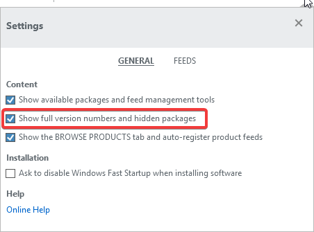

I'm not as familiar with LabVIEW NXG versioning but do you have the "Show full version numbers and hidden packages" item checked in the NIPM settings?
If you uncheck that, do you see the version change back to something more human readable?

Unchecking shows my the baseline versions, strange that they can't show both when it's checked.
