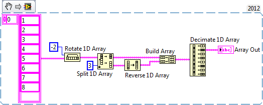

What are the contents of Array Out following execution of the (pencil and paper required) VI?

a) A 1D Array containing {1}
b) A 1D Array containing {2}
c) A 1D Array containing {4}
d) A 1D Array containing {8}

I'll go with C).

C

C.

C

C.  I've used rotate, but never decimate.  I had to look up what decimate did.

Answer: C.  Nice one DavidCorney, LordNobady, nik35324, crossrulz & MrStevenUND.

Hi friends,
I go with answer A. Since the decimate array is extented to 8 outputs the output array may have only one element at this case and it's 4.
If you think there is only one element and it is 4, then why isn't your answer C?

Apologies crossrulz, my mistake.
Agree with your answer..

I think the Perfect CLAD question. 1 Question 4 functions
