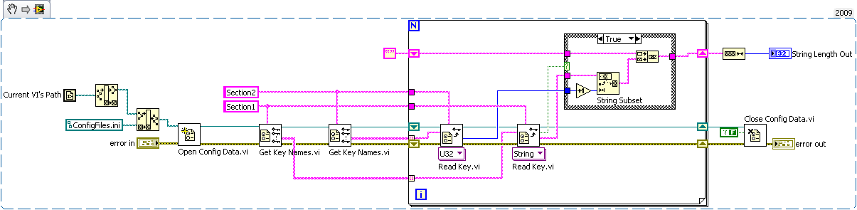

A text file; ConfigFiles.ini is stored in the same location as the VI below and its contents are:
[Section1]
1=Steve
2=Likes
3=LabVIEW
4=CLAD
[Section2]
1=3
2=4
3=5
What is the value of String Length Out following execution of the VI?
NOTE:  The Case Structure FALSE case wires the upper most input tunnel to the output tunnel.
a) 14
b) 15
c) 16
d) 17
