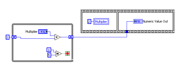

Given an intial value of 0 for 'Multiplier', what are the possible values of 'Numeric Value Out' following execution of the VI?
a) 0 only
b) 64 only
c) 0 or 64
d) Undetermined

A very nasty gotcha.
I agree with crossrulz. C because order of execution is not guaranteed.
Not applicable
I vote for C as well. This is a nasty race condition.

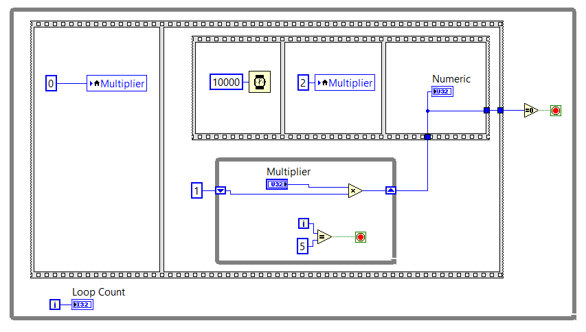

Run the code shown above to 'force' the race condition and get 0 as the result.

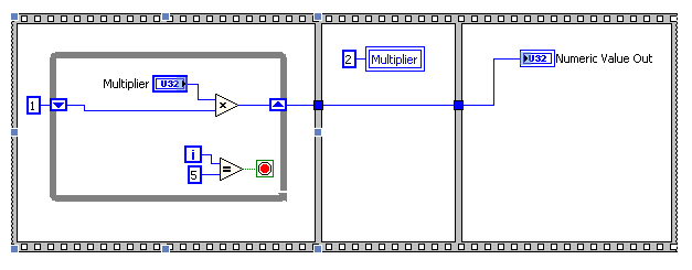

Here's the code I used to get 0

C. Oh how I love race conditions...
Edit:  I think I'm going to change to D.  I think it is possible the an iteration or two of the while loop could be execuited before the sequence starts.

For clarity then, what would be the answer if I had wired the output of the While loop to the first frame of the sequence structure?
That's an obvious A
No doubts that would be A.

Remember that the initial value for the multiplier is 0.  So if any iterations got done before the first frame of the sequence structure, you will constantly have 0*X, which is 0.  In short, you get 0 if any iterations happen first or 64 if the sequence structure frame is performed first.

gnshmrthy , the answer is C. The code in the question will return the value 64, 99.99999...% of the time, but there is always the chance it will return 0. The solutions crossrulz and I presented simply make the odds of the race condition occuring lower. This is a really nasty race condition that could go undetected for millions (even trillions) of iterations and then one day it will happen.
