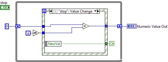

The following VI is run. Some time later the user performs a left mouse button click and release on the 'stop' control. Assuming a 'switch until released' mechanical action on the 'stop' control and an initial value of FALSE, what is the value of Numeric Value Out following the left click and release?
/servlet/JiveServlet/downloadImage/38-7228-28907/Event+Structures+%232.bmp
a) 0
b) 1
c) 2
d) 3
