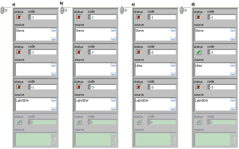

What are the contents of 'Error Array Out' following execution of the VI?

I think B
I don't know why, just a guess

B
I admit I had to look that guy up.  Basically, it takes the first non-zero error code and makes an error out of it.  But if the error in is already an error, that just gets passed along.  So the real key here is noticing that your error 2 is a warning (boolean is false).

Ans Is C

Answer is B.

B.  Open up the VI and take a look...

Answer is B.
First Iteration the error is visualized and array 1 is error since the second iteration does have error the first error is repeated adian, the third iteratuion is visualized and appended all three to an array.

Answer: B.  Nice one LordNobady, crossrulz, RAMESHB, MrStevenUND & gnshmrthy.
Not one I have used before either.  Nice explanation crossrulz.
