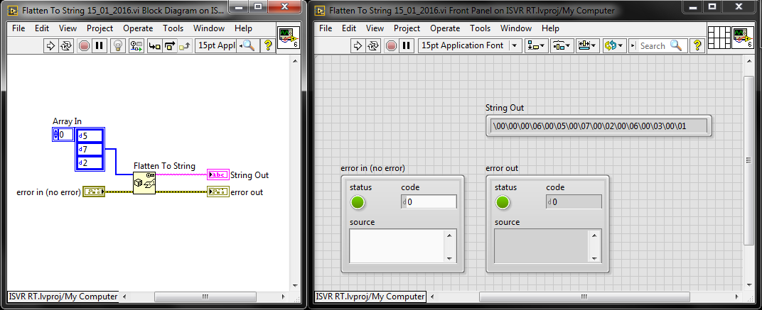

With the Indicator String Out set to '\' Codes Display.  What does its value (following execution of the VI) as shown below tell us about Array In?
a) It is an array of 3 8-BIT elements
b) It is an array of 6 8-BIT elements
c) It is an array of 6 16-BIT elements
d) It is an array of 6 32-BIT elements
NOTE:  The size of Array In and the values stored within each of its elements have been chosen for the benefit of this question, other sizes and values may not flatten to string as nicely.
