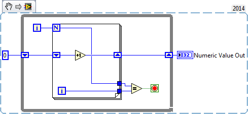

What is Numeric Value Out following execution of the VI?
a) 0
b) 1
c) 2
d) Undefined (the VI does not stop)

The For-Loop will not execute...so A

Yes, I agree the For Loop will not execute. As far as I learned few days ago here in this forum we getting default values 0.
So one default value 0 is equal to the other default value 0. The while loop stops and gives the third default value 0 to the output.
update: it is not the third default value, it is the init value of shift register, Thank you LordNobody for make it more precise
A

A
LordNobady
Member
A.
As Andreas says the For loop will not execute, default value = default value so the while loop gives the initialization from the shift register from the for loop as output.
with that set to 0 the answer is 0.

A

A

A.

A

Ans : A, for loop will not execute and while loop will stop in its first iteration.so What ever the value we are passing as input in shift register will be the output.

A

A

Ans:A for loop will not execute.

A

A... For loop does not execute

Ans:A
