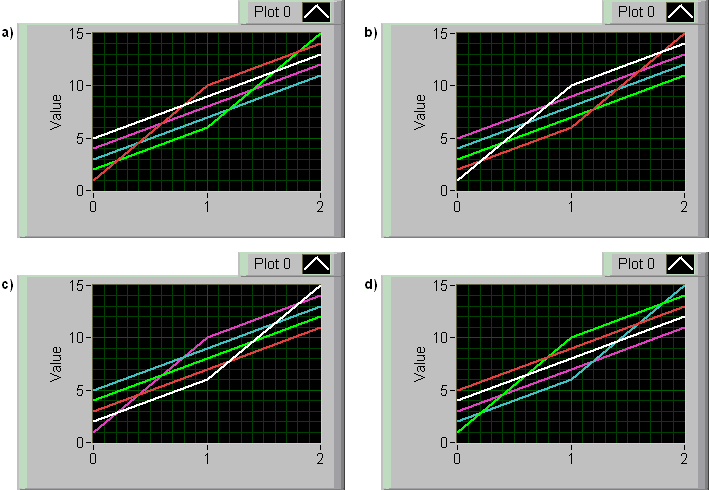

SB: Probably a bit too complex for the CLAD, but pretty good fun.
Which of the following Waveform Graphs is displaying the data generated by the VI?
HINT:  This question MUST be viewed in colour.

Ans is B

B

B
Yeah, that one was a little hard for a CLAD.  I needed pen and paper to keep the arrays straight in my head.

B

Ans:- B

ANS:- B

Answer: B.  Nice one SakthivelMuthusamy, ambaum01, GM, RAMESHB, Asha_Nagaraj & Neelamma.
I thought this question was going to be much harder than your Comments suggests.

I`m late to the blog I suppose, the answer is B and what happens when we try with Charts?

Ans is B

I am so sorry but I dont see where is the differece in the four graph. Can you explain me!?
crossrulz
Knight of NI
Look at the colors of each plot.  The legend in each of them tells us that Plot0 is white.  With that information, you can figure out this question.
