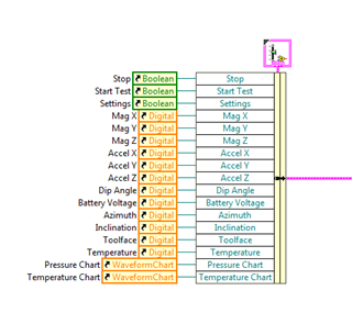

We have an internal tool at Erdos Miller that we've turned into a product. It's a node that outputs a cluster of references to all controls on the front panel. A free trial is available for download here:
http://info.erdosmiller.com/node-control-references-software-download-v1
It replaces code like this:
With a single node:
It also lets you:
  • Bind the output type to a typedef.
  • Include a reference to the owning VI and/or the owning VI's front panel.
  • Exclude references to controls above or to the left of the origin.
  • Optionally exclude controls individually.
Controls on tabs are organized into page clusters. Try it out and let us know what you think!
