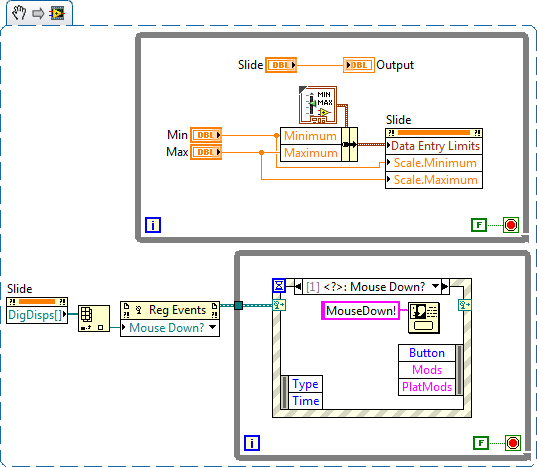

Here is a subvi I made to detect a click on a digital display.  I put this in an event loop to detected ether a right click event and launched from a menu or as a double click event.
To set the data limits I don't really understand your problem, you should be able to set this using property nodes:
X controls are pretty strait forward, and I did make one that does what you are discribing.

I'm confused --> is this what you're trying to do?  Seems to work for me (LV2011)

Wow, thanks for the great responses guys! joshe and Simon, thanks for the code snippets. DFGray, tha'ts a good idea for a workaround.
Simon, for whatever reason, I still can't get either of those properties to be writable. I added my control file to the original post: can you try it and let me know what you see?
(4,815 Views)
Accepted by topic author David_Staab
Ah, it's because I had it set as a strict typedef. Evidently that means you can't change the range limits. Darn...I guess I won't be able to enforce visual style, size, and layout thorugh the type definition. Oh, well.
