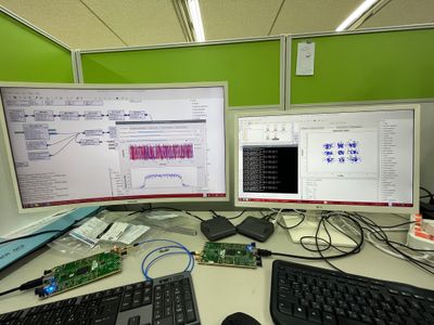

For hardware set-up, I'm using Raspberry Pi 4 (4 GB) to execute GNU Radio Companion, and using USB 3.0 port and cable to connect RPi and USRP B200. And I connected a DC block at the Tx port, as described in USRP homepage manual for DVB-S2. (So, the sequence is RPi 4-USB 3.0-USRP (Tx)-DC block-SMA cable (1 m)-USRP (Rx)-USB 3.0-RPi 4)
I have attached my hardware set-up pictures below.

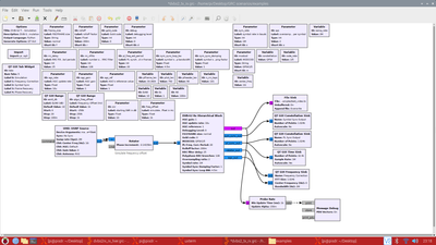

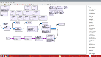

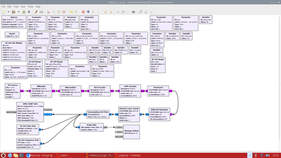

I am trying to send some sample video through DVB-S2 communication. And I got DVB-S2 GRC flowcharts from links below. I've attached the screenshots, too.
KakaoTalk_20221002_232855028_01.pngKakaoTalk_20221002_232855028_04.pngKakaoTalk_20221002_232855028_03.png
