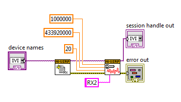

I'm using an NI-USRP 2900 with LabVIEW and I wanted to know how sessions worked. Is it possible to run a VI that will open the RX session then run another VI that will use that session in order to Fetch RX data. I tried it but it doesn't recognize the session handle.

I tried but it doesn't work. For instance what I want to do is run a VI that does this :
Then another one that does this :
But not inside another VI. Both shall run once and separately. The first one will run, end, then I would run the second one using the session handle.

Actually I want to turn the VIs into a .NET interop assembly and use them as actions in testexec SL, and since I want to be able to acquire when I want without waiting for the session to open, I need to separate the Init and Config from the acquisition. The main problem is that "Open RX session" is way too long and stop me from running the VI quickly multiple times.

Actually a solution that I may have found is to use a VI server in order to call a VI in background that will run a loop. By doing so the session stays open until the background VI is running. For now it isn't working but I think I'm on the right way.
