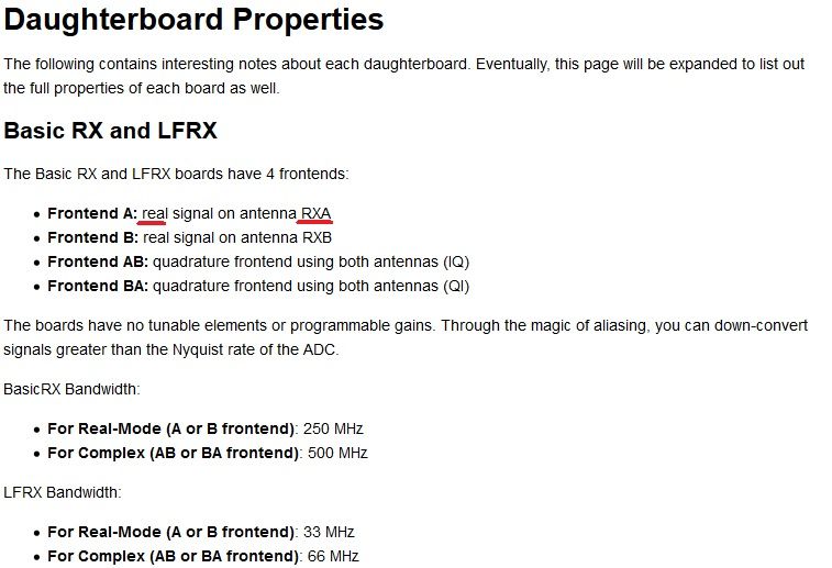

1) yes, I have an external mixer and its IF output is connected to the SMA input port of the USRP2/LFRX-LF. My doubt was if at the RX-A or RX-B port of LFRX-LF it was possible to acquire complex signal or if this daughetrboard "cuts" the complex signal and what you can acquire is only the real part of the signal.
2-3) thank you, I'm trying to find the official settings but I've found only docs for GNU Radio and not for LV. Then I'm not sure if the parameters I've set (RX-A, RX-B, ...) are correct and if, to get the complex signal, I ahve to use some specific parameter (AB? RX-AB?).

Could help, thanks. But why in the ettus official pages they write "Real signal", if in the link you mention it seems you can get a complex signal?
(6,127 Views)
I and Q are still the output of the LabVIEW VI. But instead of real and imaginary it's just channel 1 and channel 2. (Two real signals)
(6,120 Views)
Smetimes the basic boards or LF boards are used with a custom down converter. In that case they are operated in quadrature AB mode.
