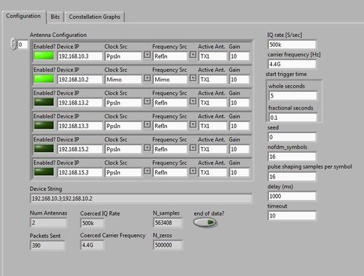

Hello, I have just managed to get it work with for the case of 2x2 MIMO! Try to do the following changes:
1) specify the 2 ips of the TX and RX and deselect the remaining ones
2) IQ rate =0.5M
3) I used 4.4G as the carrier frequency
4) nofdm_symbols=16

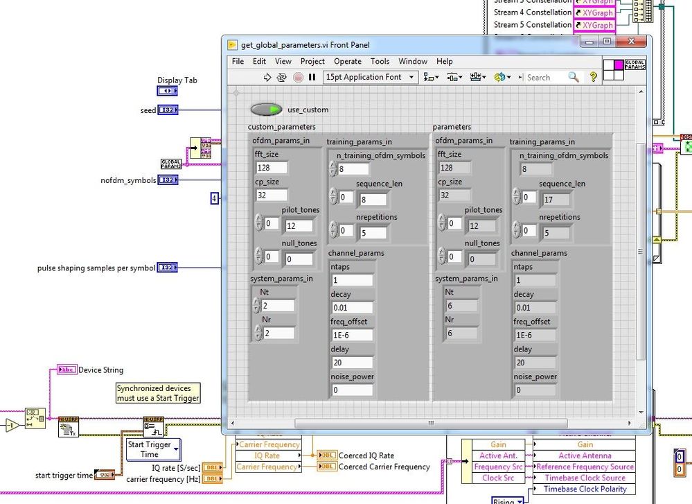

5) sequence_len=8 and Nt=Nr=2 and set the custom params (at the OFDM params control)
6) the the timestamp to now
Hope it helps!

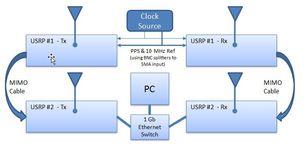

In particular I have a system design like the the following one:

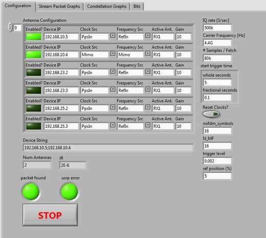

I am sending you the screenshots of the TX/RX front panels
and also my custom global parameters:
