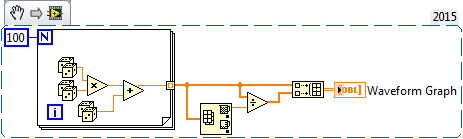

if you want to scale your signal why dont just do it manually (find the maximum and devide the array by the maximum).
(The left part is just to create some random values.)
