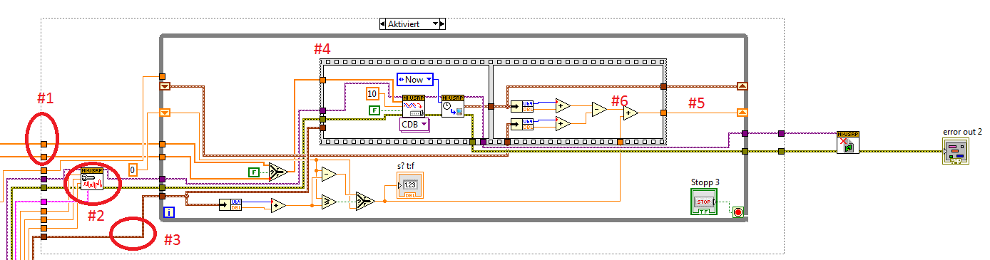

I hope this screenshot is also sufficient.
Before this part I am only initializing the USRP board with my IQ-Rate (1.62MS/sec) etc. (#2), generating the OFDM-Blocks/Zero-Blocks (#1) and providing my interval time (#3, e.g. 0.5 seconds). In the sequence structure (#4) I transmit my choosen block (normal Zero-Block), get the USRP-Board time and add the additional time since the last transmission to my total time value (#5) which is basically my counter. If this time becomes greater than my time intervall from #3 I want to switch from only transmitting blocks containing zeros to my OFDM Block. But from #6 I know that although my transmission of e.g. 10000 samples with a sample rate of 1 MS/sec should take about 10 ms the time difference in #6 is only about 1 ms. So basically the data is send to the board in 1 ms and then jumps back to the beginn of my while loop and transmits data again. Because of this I can never be sure when my OFDM-Block is transmitted (Don't know the state of the buffer).
What I want is for the VI to only transmit data after the buffer is empty. If I try the same setup with "end of data=true" I get an addiotional 60 ms delay.

I think the best way to be sure that no value gets lost is the producer consumer architecture.
Maybe you should give it a try
If you don't know it you can read some basics here:
https://www.ni.com/en/support/documentation/supplemental/21/producer-consumer-architecture-in-labvie...
This should do what you want i think 😉
