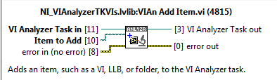

When I load the config file in the ViAnalyzer wizard, I can only add VIs or Folders as test targets. The problem is the same when using the AddItem VI of the API.

there is a way by using the LV Analyzer API. Create a new Task with "VIAn New Task.vi". Get a reference to your Project on which you wanna do the analysis and get all project items of this. Add every item (better is only the .vi files) from your project with "VIAn Add Item.vi" to your analyzer task and run it with "VIAn Run.vi"

Thanks for your quick answer. I'll try and see if it's not too long to make an AddItem on each VI of a project. I hoped there was another solution that makes me do less code...
(5,269 Views)
After testing, it takes around 45s to add 1654 items to ViAnalyzer API.

I agree this would be a useful feature, and it is something we can keep in mind for a future release. For now, the best workaround I can suggest is to write a VI that parses the project to get a list of the VIs in the project, then performs a programmatic analysis using a .cfg file with tests pre-selected and configured.
