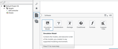

Hi Harvey_He,
You can add .vsmodels and any supported Simulation Model directly from the Mapping Diagram as shown below. This allows you to add models to your System Definition File without needing to open System Explorer. I tested with your model, and it imports and deploys successfully. As you discovered, System Explorer does not support importing .vsmodels, we recommend using the Mapping Diagram.
Once you select the Simulation Model from the palette, you can drop it on the diagram and then browse to your model.
From there, you can complete a variety of your next tasks, such as setting the model rate, create mappings, etc...This section of the VeriStand 2021 manual discusses this topic.

Dear Brian.D,
Many thanks to you, I successed to add .vsmodel following your instruction!
