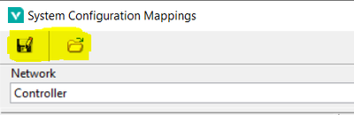

If you are using the Mapping Diagram, you can remove the broken items with a single click.
If you are using the System Mapping from the System Explorer, you can export the mappings to a txt file and modify it using Notepad++.
