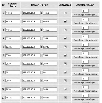

Good hint but the solution to solve my problem consisted of two steps:
1. Installation of right VeriStand Version together with the correct packages and the right X-Net Database (related to my VeriStand-Project) installed on the real-time-systems.
2. Correct router setup with right port-forwarding adjustments inside my router. I could find the ports which VeriStand and the MAX uses with the tool "Wireshark".
