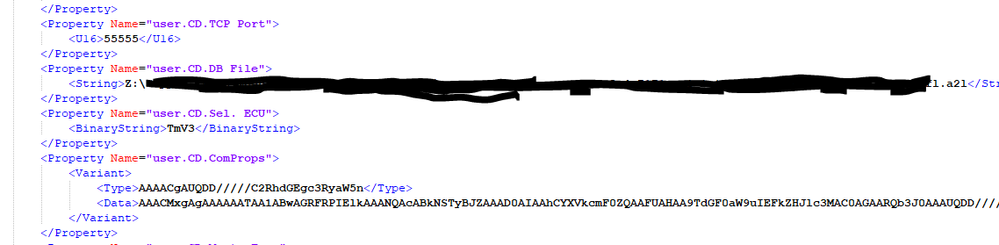

One Workaround I've already looked into:  I at first thought that if the above was going to be such a hassle, why not just change the XML directly.  Unfortunately, while the A2L file path is in plain text, the Communication Properties (which contain the DTO and CRO IDs) is some kind of encoded string, whose format I have no way of knowing:
When I diff the strings after changing from one A2L to another (again, only the two IDs are different), a huge quantity of the string in the sys def is different, so it's probably not just some simple conversion I could reverse engineer.  In principle, calculating an encoded hash shouldn't be limited to 32-bit operations only, so I know what I want to achieve is definitely possible in 64-bit.  I think I've exhausted what I can do with the information I have, though, so I'd appreciate any further insight you may be able to provide!
