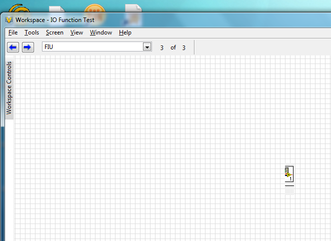

 I finished doing this last evening after your suggestion and I believe I made some progress.  Now I am not getting any errors but there is nothing to choose when the dialog pops up so I am going to take a closer look at it today.  Also when trying to place it in the workspace it shows up as a small icon that is cut in half.  I included a picture below.  I don't know why it doesn't show up as the front panel of my control.

The FIU control you used as an example unfortunately does not use a library to namespace. So I suggest creating one for your control.
The sizing of the front panel when dropped is determined by the VI properties for minimum panel size. Make sure that is set as desired. I suggest resizing your front panel to desired size then go into VI properties and click the "set minimum size" button to just apply the current size. The other options in appearance also work so make sure the status bar and all the other crap is hidden.
