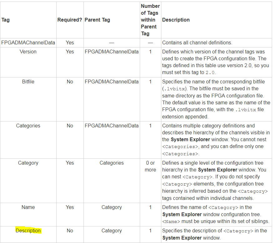

Hi everyone! I am dealing with a file with extension .fpagconfig. I wonder if the sentence in the <Description> </Description> works or not. Does it only play the role as description? I found that the existing .fpgaconfig has some faults in the description but I don't know whether it matters or not. Thanks very much!

Referring to the Veristand Help, the description tag is not compulsory and it is just to provide explanation. I don't think it affects the functionality of your code.
http://zone.ni.com/reference/en-XX/help/372846H-01/veristandmerge/creating_custom_fpga_configuration...
