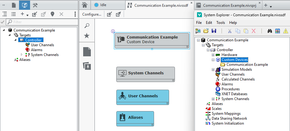

I created a new VeriStand project and added the Communication Example custom device in System Explorer. Target’s Operation System is Windows and its IP address is localhost. I press Deploy and run the Example Client VI. It works fine.

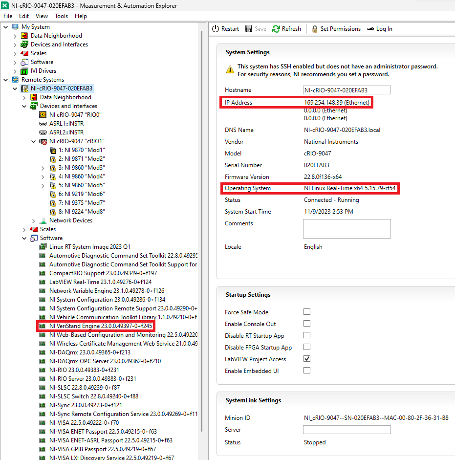

Now I want to deploy the example system definition file to the cRIO RT target. Target’s Operating System is Linux_64 and IP address is 169.254.148.39. I press Deploy and get these error messages.

Did you create the custom device using the template shipped by VeriStand or niveristand-custom-device-wizard
The custom device XML should define SupportedTarget of Linux_x64. You should also need to build Engine Release for Linux_64.lvlib. See Create VeriStand Custom Device for Real Time Target

Thank you for the pointers. The custom device is one of the examples that came with VeriStand. I didn't use any template or wizard. It seems I have to digest more basics first to make sense of it.

Have you edited your VeriStand system def (press the config button) and clicked on hardware to set the IP for the system def to deploy to?
