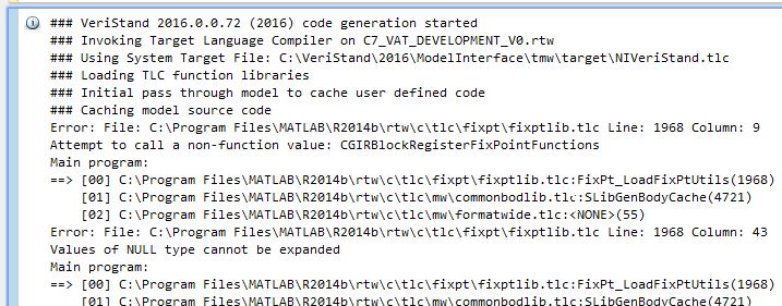

It doesn't give any reason for the failure but digging back through the diagnostics I found the following....

I am Ed from National Instruments Applications Engineering. I have had a look through the material you have provided as to the error you are receiving, it looks like fixptlib (at a guess as I'm not too familiar with Simulink) might be referring to the fixed-point type definition library.
We could be missing the VeriStand Model Framework from installation of VeriStand, can you confirm that you completed the steps given in the below article:

The issue occurs before executing VeriStand's scripts. The problem occurs within MathWorks' TLC source file, fixptlib.tlc.
