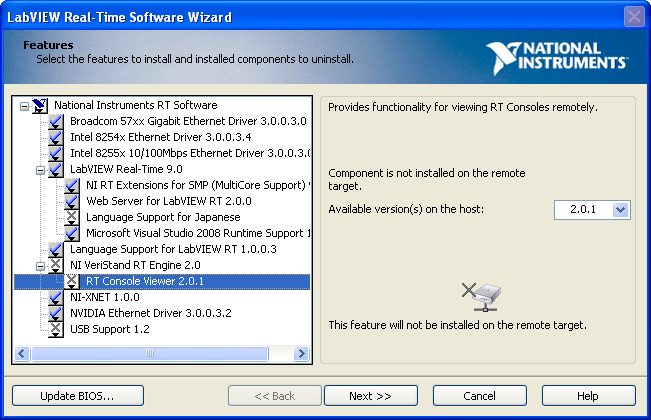

For now, you can uninstall the Console Viewer support without adversely affecting the VeriStand Engine running on the RT target. To do this, go to Measurement and Automation Explorer and select the Add/Remove Software option for your RT target. Under the main NI VeriStand section header, you'll see the Console Viewer utility. Select to uninstall this if you like.
