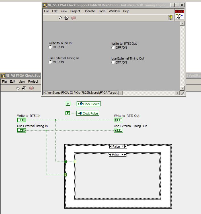

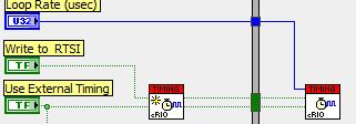

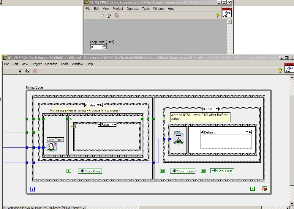

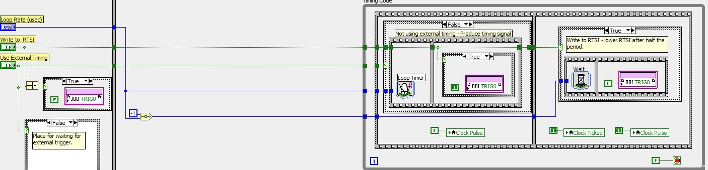

Yes, there is a difference in the FPGA code between the project (C:\Users\Public\Documents\National Instruments\NI VeriStand 2016\FPGA) and a project that I created with the project wizard under VeriStand Custom FPGA Project that comes with the VeriStand FPGA-Based Interace I/O Tools http://forums.ni.com/t5/NI-Labs-Toolkits/NI-VeriStand-FPGA-Based-I-O-Interface-Tools/ta-p/3493285.
VeriStand Custom FPGA Project:Sync_Custom_VS1.JPG
Timing:
So there is no Timing/Sync.
C:\Users\Public\Documents\National Instruments\NI VeriStand 2016\FPGA:

Yep. On the first picture is visible, that the set of vis was cRIO/sbRIO version. You need to use the set for PXI...
