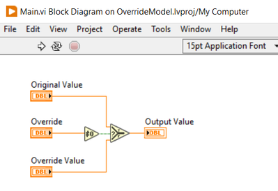

You would need to implement the override checking logic, either in that model, or another model that acts as a gatekeeper. For example, as shown in the VI below.
J1939 custom device only exposes the override feature for the protection and counter channels. However. those channels generate their own value instead of receive value from another channel, when not being overridden.
