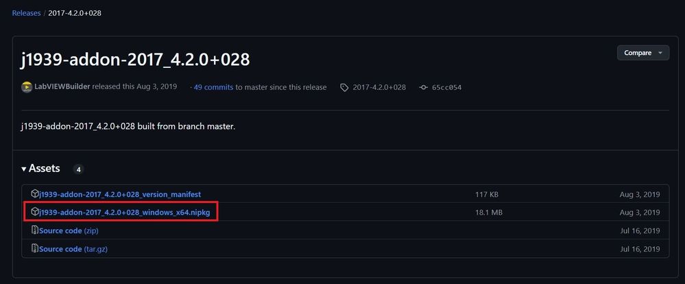

Try the built file from Release j1939-addon-2017_4.2.0+028 · NIVeriStandAdd-Ons/J1939-Custom-Device · GitHub

The built file is available in the released link I shared.

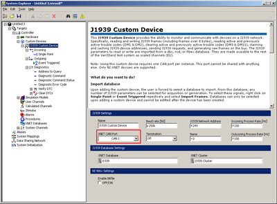

I dont know where I can check that. When I add the custom device it only asks for XNET database & XNET Cluster name which auto-populates, so
1. There is no option to select XNET Interface Name.
2. If I remove the Custom Device from my sysdef, my project gets deployed successfully, this error is coming only when I added the J1939 AddOn.

You can change the XNET Interface in the Main Page.

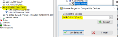

The name comes by default in Veristand & attaching the snapshot of that (Left side NI MAX, Right Side is Sysdef)
But the error is still same during deployment:
• Closing WebDAV session...
• Files successfully deployed to the targets.
• Starting deployment group 1...
The VeriStand Gateway encountered an error while deploying the System Definition file.
Details:
Error -1074384704 occurred at Project Window.lvlib:Project Window.vi >> Project Window.lvlib:Command Loop.vi >> Project Window.lvlib:Connect to System.vi
Possible reason(s):
NI-XNET: (Hex 0xBFF630C0) A property value was out of range or incorrect. Solution: specify a correct value.
NI VeriStand: NI VeriStand Engine.lvlib:VeriStand Engine Wrapper (RT).vi >> NI VeriStand Engine.lvlib:VeriStand Engine.vi >> NI VeriStand Engine.lvlib:VeriStand Engine State Machine.vi >> NI VeriStand Engine.lvlib:Initialize Inline Custom Devices.vi >> Custom Devices Storage.lvlib:Initialize Device (HW Interface).vi
