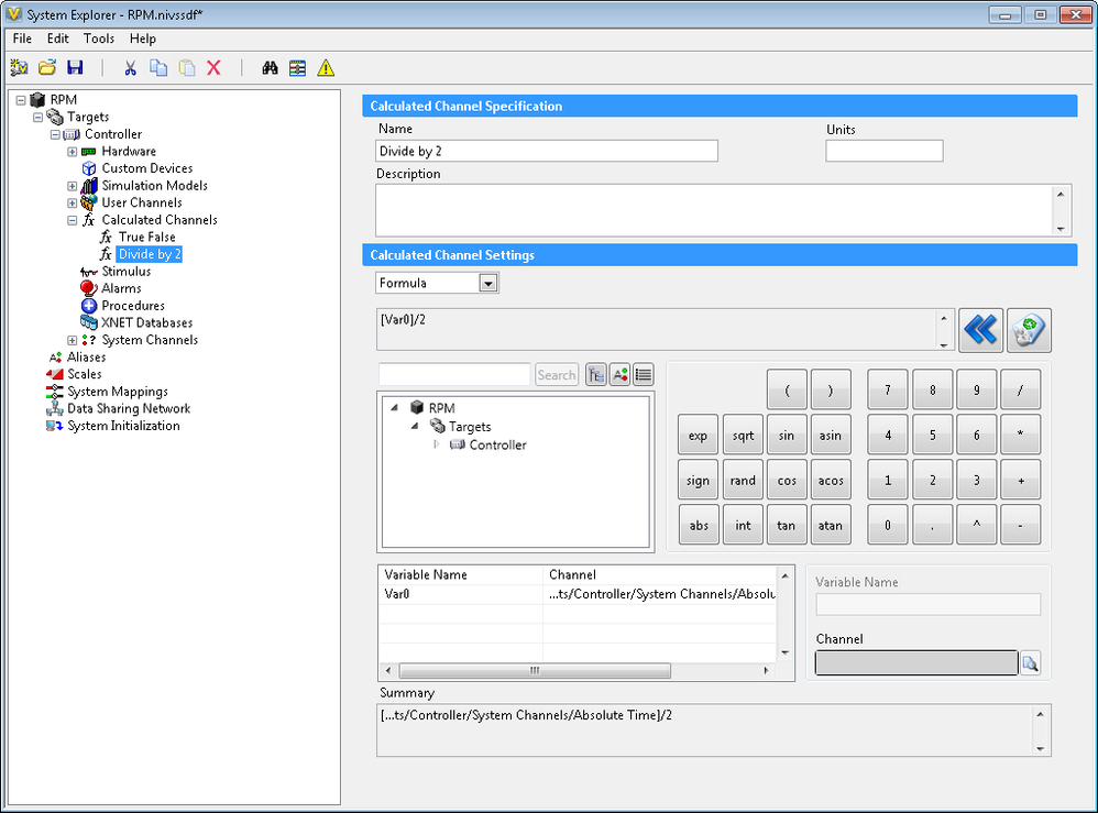

I was wondering if there is any additional mathmatical functions in the Calculated Channels Formula settings.
