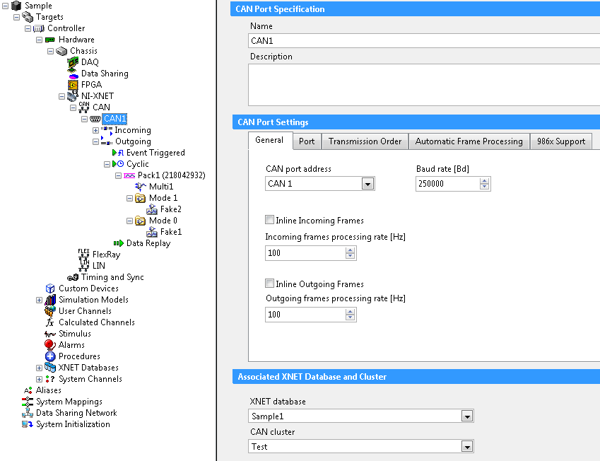

I am having a problem with using the XNET in VeriStand. I have set up my database with two modes. When I try to send it the CAN messages out, it only ever sends mode 0 messages, it never send mode 1.

I am the Applications Engineer who is working with the above customer. My solution to this issue: we need to specify the mode using the Multi1 channel. The value of this multiplexer channel determines whether Fake1 or Fake2 is outputted. By not controlling Multi1, it remains set to 0 causing the Mode 0 signal to output (Fake1).
