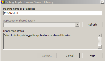

Working on this... Are you assuming the VS engine runs on a Windows PC, or a RT Target (my case here)? So far, I do not see the model in the list of debuggable applications. I confirm it is running in the VS engine, as indicated on the VS status screen.
Still trying...

Still no luck.  As far as the remote panel on a RT target. I am not aware the RT target running VS engine supports the remote panel server. Does it ?

I got it working on a PC Engine. I have not tried this on RT before. RT does support remote debugging for a debug-enabled rtexe, but I am not sure if it works for a debug-enabled DLL loaded in that environment.
Remote panels should work for custom devices and models on RT, but there's another set of steps to get it working. What I've done before is to deploy a LabVIEW project to the RT Target with the correct VI Server permissions set. This obviously unsets the VeriStand Engine from running as the startup executable. But then after that you can reinstall VeriStand support from MAX and I believe the VI Server permissions persist. This allows you to view remote panels if you know the exact qualified name of the VI you want to open. Finding that out can be tricky, especially if the VI is reentrant, because you need its clone name (i.e. "mylibrary.lvlib:myVI.vi:2").
