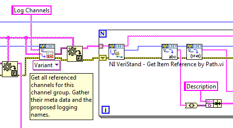

***NOTE***
This is still the referenced code, but the method that Stephen posted below should be used instead.
For posterity's sake, here's the relevant code that's been referenced:
From the configuration saving (Windows side):
And the RT Driver side:

Actually, I forgot, NIVS 2009 (which that code is based on) did not include the 'dependent item' property type. So the code you posted above and the code jarrod referenced are not best practice anymore. I'll post a snippit of what you should do in just a second.
Stephen B
Message 8 of 11
(7,921 Views)
Do this! (not what was posted above)
And then you can just open data references to that item
Stephen B
