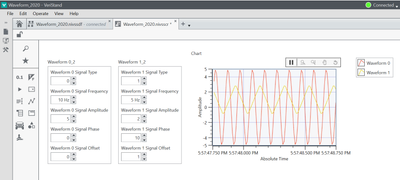

I apologize for giving the wrong information. I was under the impression that the chart on the editor screen does not support the waveform channel. I just found out that in fact it is supported.
You can refer to NIVeriStandAdd-Ons/Waveforms-Generation-Custom-Device to understand how you can create and write data to waveform channels.
You might need to increase the streaming rate for some high-frequency waveforms to display properly. Chart on NI VeriStand UI Manager Displays Fixed Data Points Irrespective of Model Rate
Here is the result I got on VeriStand 2020 R6.
