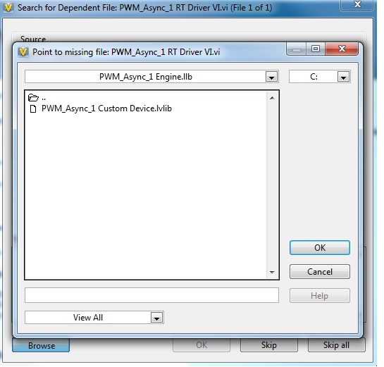

Now when I open Veristand I get this pop up:
If I ignore it, and deploy the custom device, it fails, saying the PWM_Async_1 RT Driver VI.vi is missing... (Error 7). However, if you look into the PWM_Async_1 RT Engine.llb under C:\User\ etc... the "missing" file is there...

Ok, so going into the PWM_Async_1 Engine.llb shows no vi. However it shows a lvlib and nothing else...
Also, looking at the llb, it is only 7KB. so the built from the project must have not worked properly. But the Build Status gave no indication of this.

Ok, here is what the problem was : At one point in my tests, I must have taken the RT Driver VI.vi out of the library, or renamed it.. This made the file dissapear from the build properties Smiley Mad, hence the message not finding it.
To re-establish the proper setup in the build, make sure the RT Driver VI.vi file is selected under Source Files, and  Source file Settings. See below where this should be done.
