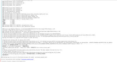

Hello  jano_rajmond,
    I installed the vs2017 as you said,but when i compile simulink models shows "can not found “\rtw\c\tools\vctools.mak”  do you know how to solve this problem,thanks!
(4,377 Views)
