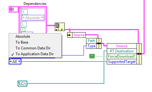

Your custom device can have complete control over which files get deployed to the target and where those files get deployed to on the RT target file system. I would take a look at this Custom Device function to add a dependent file. You specify the location of the file on the host and the location on the RT target where you would like the file to get deployed to.

Question though - I'm not sure which of these directories each of these actually refer to.  I read the descriptions in the help, but I always have issues matching up directories without using absolute paths.  I want to use relative paths as to make the program more flexible if someone uses a different directory structure than I do.  Right now when I build my custom device it puts the text files in ...custom devices\customdevicename\data\filename.txt  Which one of those choices coincide with that?  Thanks.

It looks like the best option is To Common Data Dir. This resolves to: <Public Documents>\National Instruments\NI VeriStand XXXX, where XXXX is the version year. So in your case, the relative path you listed starting at Custom Devices would be all you'd need to add with this as the base.
