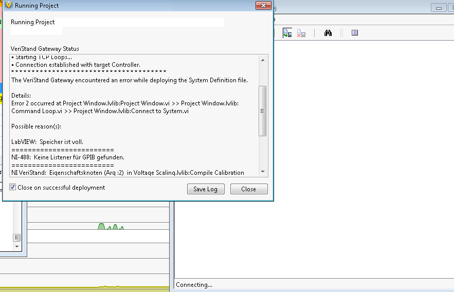

   GUI reports an error after sometimes (ca. after 200 test cases) and tells me:
   - LabVIEW Memory full.
   - StimulusProfileSessionService.lvlib:ECreateSessionDataCache.vi.ProxyCaller
   (See picture for more detail)

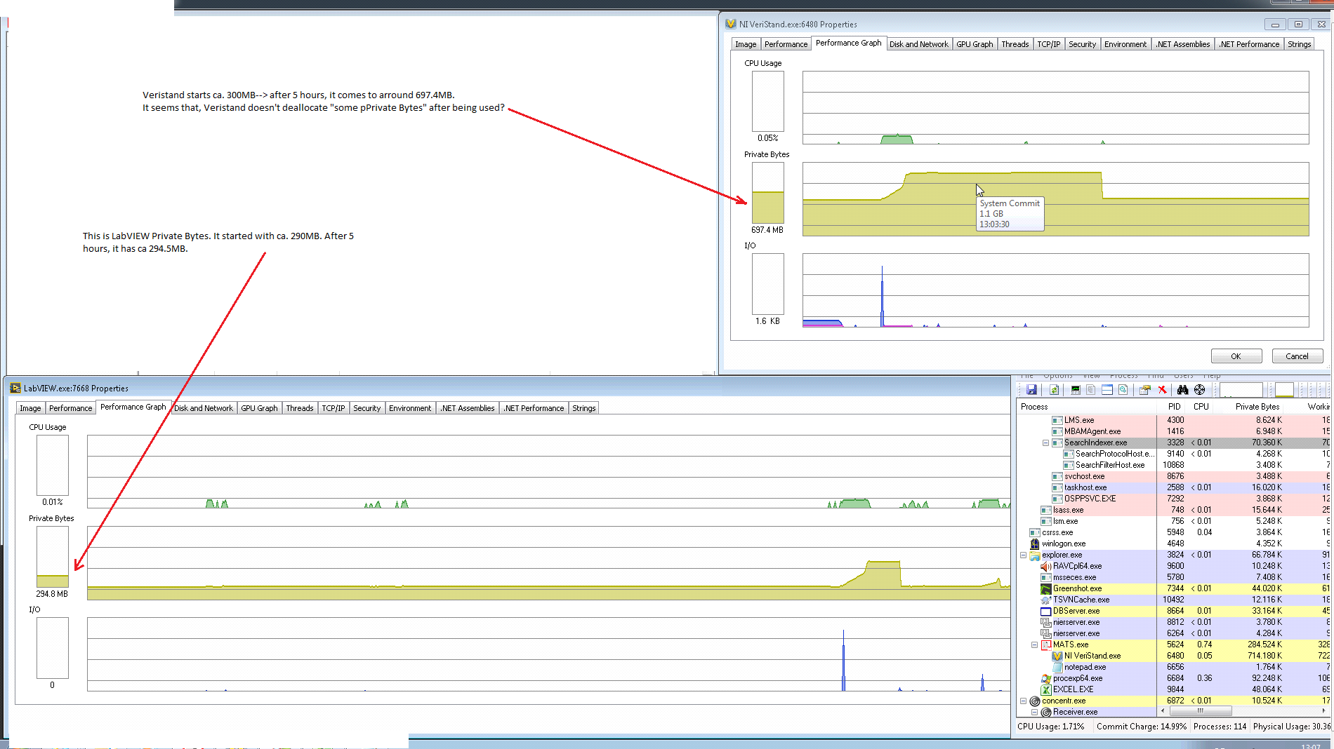

Here what i have monitored during the test until "LabVIEW memory full" comes:
1. No memory leak detected from "LabVIEW Desktop Execution Trace Toolkit"
2. Everytime RT-Sequence is called and deployed, memory is increased but it will decreased again as i have released them.
3. To my understanding:
   LabVIEW has no issue of memory growth. there was a peak (up to 1.169GB), but stil under max 2GB.
   Veristand has no issue of memory growth. there was a peak (up to 1.268GB), but stil under max 2GB.

- Once i tried to redeploy the same system definition, the following windows popped-up:
- So, still the same error:
The VeriStand Gateway encountered an error while deploying the System Definition file.
Details:
Error 2 occurred at Project Window.lvlib:Project Window.vi >> Project Window.lvlib:Command Loop.vi >> Project Window.lvlib:Connect to System.vi
Possible reason(s):
LabVIEW:  Speicher ist voll.
NI-488:  Keine Listener für GPIB gefunden.
NI VeriStand:  Eigenschaftsknoten (Arg :2)  in Voltage Scaling.lvlib:Compile Calibration Binary from XML.vi->NI VeriStand Server.lvlib:NI VeriStand Server.vi->NI VeriStand Gateway.lvlib:VeriStand Server Wrapper.vi
And this is what process explorer reported:
Why Veristand's private bytes is always increasing? Any idea how to clear / cleanup its unused memory?
