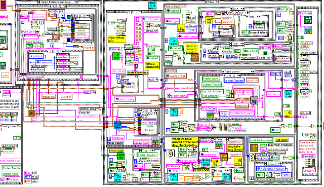

So I've gotten stuck maintaining/upgrading someone else's code (they retired).  The code works, but its complete spaghetti.  The project manager (who is not a programmer)  thinks the guy who retired is a Labview expert because he somehow managed to make it work.  spaghetti.gif
Anyway my point is everytime I say something to the project manager about taking some time to clean things up and make it understandable, his answer is "It works, blah, blah, blah.  There's no need to spend any money fixing it.  If you can't understand what's going on, talk to the guy who wrote it (who is still around even though he is retired)"  In the meantime though, any time he asks me to do any kind of upgrade/maintenance it takes me at least a week to figure out what is going on (It even takes the guy who wrote it a week to figure out what is going on), and I usually end up with all kinds of crazy race conditions due to all the global variables.
Even the guy who wrote the code agrees that it needs to be cleaned up.  He claims he's never had the funding to fix it.  My question is how do I get the project manager to realize that in the long run it is worth it to spend some time rewriting/editing the code and making it more understandable and more robust?  This is a program that has been around for years and we're continuing to sell it.  And we are going to have to maintain it for years to come.  In my mind the manager is being very short-sighted.

Diagrams like that make me squirm.
Believe it or not, there may be a reason the code looks like that if it was originally developed in LV 5 or before. All GUI attributes (that what they were called before property nodes were introduced) had to be in the top level VI. This is one of the reasons I was very impressed by LV 6. Small monitors also encouraged those types of diagrams. A few "replace stacked seq with flat" follwed by a diagram clean-up would go a long way with this VI.
As far as the race conditions are concerened...
everytime you run into a race condition replace all offending globals/locals with Action Engines. Only replace as many as are involved in each problem. In the long run you will end up re-writting most of teh app and the rest... well we don't have to "wash the spare tire everytime the car is washed".
I have been maintaining code that looked very much like that code for years and with the upgrade to LV 8.2 I was able to finally get it cleaned-up.
Sorry I can't give a more convince reply.
