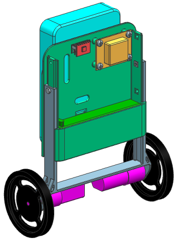

The result is the so-called Hybrid Concept with an adjustable center of gravity and the possibility to realize a Multi-sensor Data Fusion. The implementation of an adjustable center of gravity could be realized through the development of a new casing for the balancing robot.

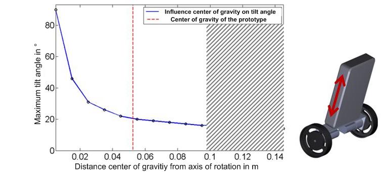

To get an understanding for the dynamic behavior of the existing balancing robot prototype, we created a model in Matlab/Simulink. Therefore, we simplified and combined components to a rigid pendulum p with two wheels w and implemented their masses and mass inertias. We used the known technical data of the actuators and simulated a straight movement with a constant motor torque in our mechanical model with two degrees of freedom: The rolling motion angle of the wheels and the tilt angle.
With our created model, we can simulate and identify different maximum tilt angles for a constant motor torque and a varying center of gravity of the pendulum. Thus the simulation shows for which maximum tilt angle the robot is able to stand up. The implementation of the iterative changing of the center of gravity is realized via a programmed Matlab-script. The simulation stops when the pendulum is in a vertical position again (until Φ=0°). With the use of the created model we could define new specific requirements for our Hybrid Concept. The aim is a high impact of the center of gravity on the maximum tilt angle and the dynamic behavior of the system. Our conclusion is to set the center of gravity in an adjustable area with a minimum of 0.1 meters distance of the center of gravity to the axis of rotation.

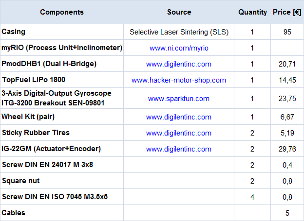

During this ADP, we compared different components from different providers. Our aim was to choose suitable parts for a good price. To find and compare suitable components, we engaged in an intensive internet research. One aim of the concept is to show the changing dynamic behavior of the actuators, due to a changing center of gravity and the resulting mass moments of inertia. Therefore, we tried to avoid oversizing components.
All parts can be bought by private customers. The estimated overall costs of the parts should be within a budget of 250 €. However, the big question mark is the production of the casing: We asked commercial providers of different rapid manufacturing methods for the cheapest possible offer. The best offer we got was a production via Selective Laser Sintering (SLS) with polyamides for 95 € per casing. The price can highly vary and depends on the number of produced casings and the production method. The casing consists of two parts and protects and assigns the parts of the balancing robot.

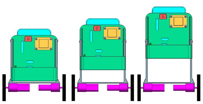

To reach a maximum variation of the center of gravity, it is reasonable to realize a flexible position of the heaviest parts of the robot: The myRIO and the accumulator. With our casing, we enable three different kinds of possible positions:
