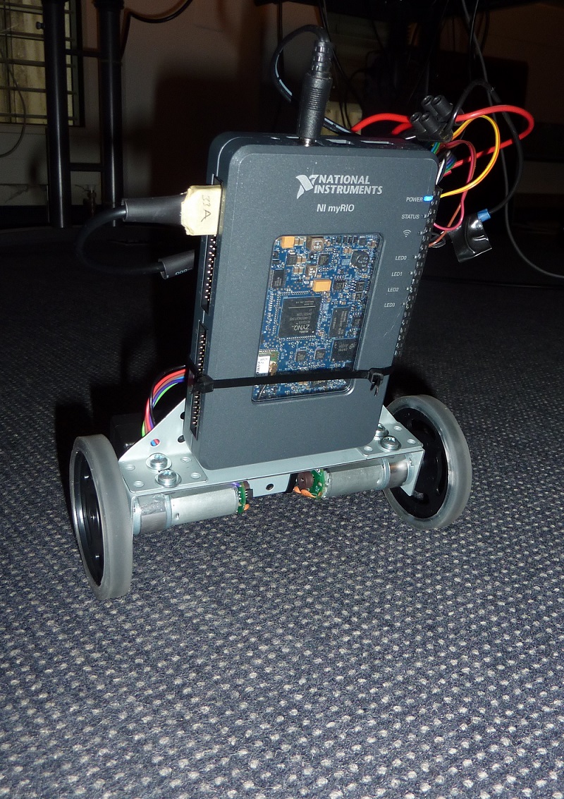

The aim of this prototype was to quickly start balancing.
Indeed, two weeks after the delivery, myBOT was able to stand, drive and turn around his axe.

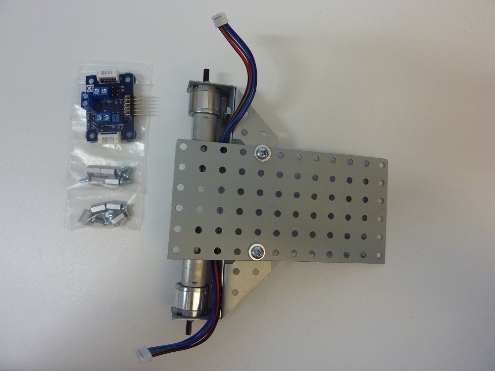

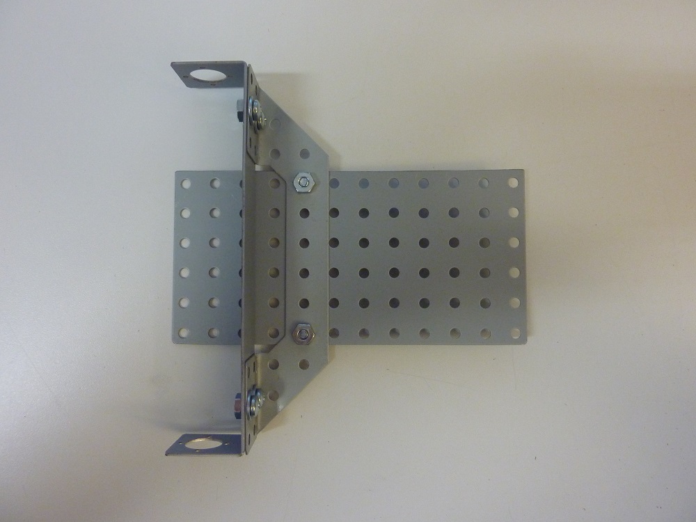

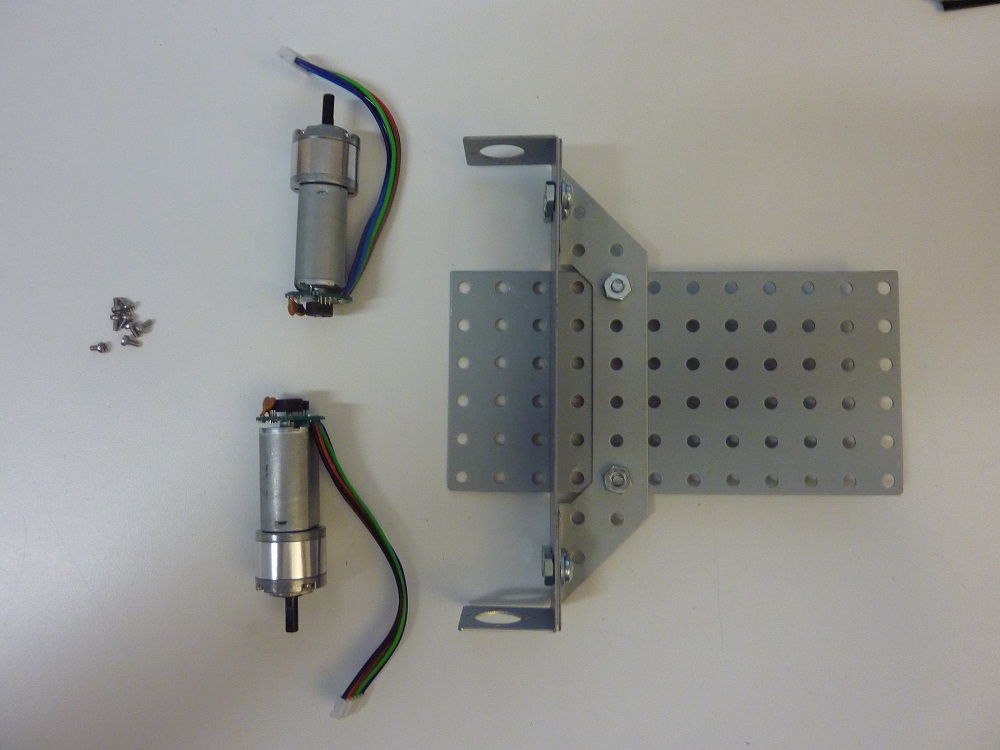

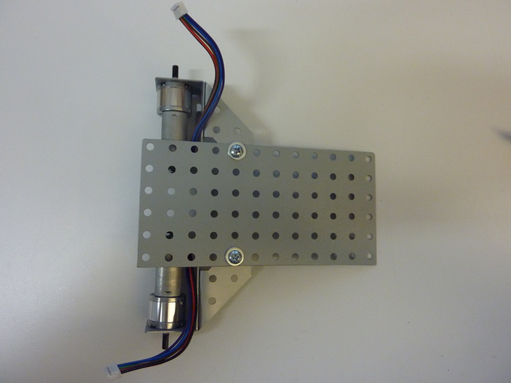

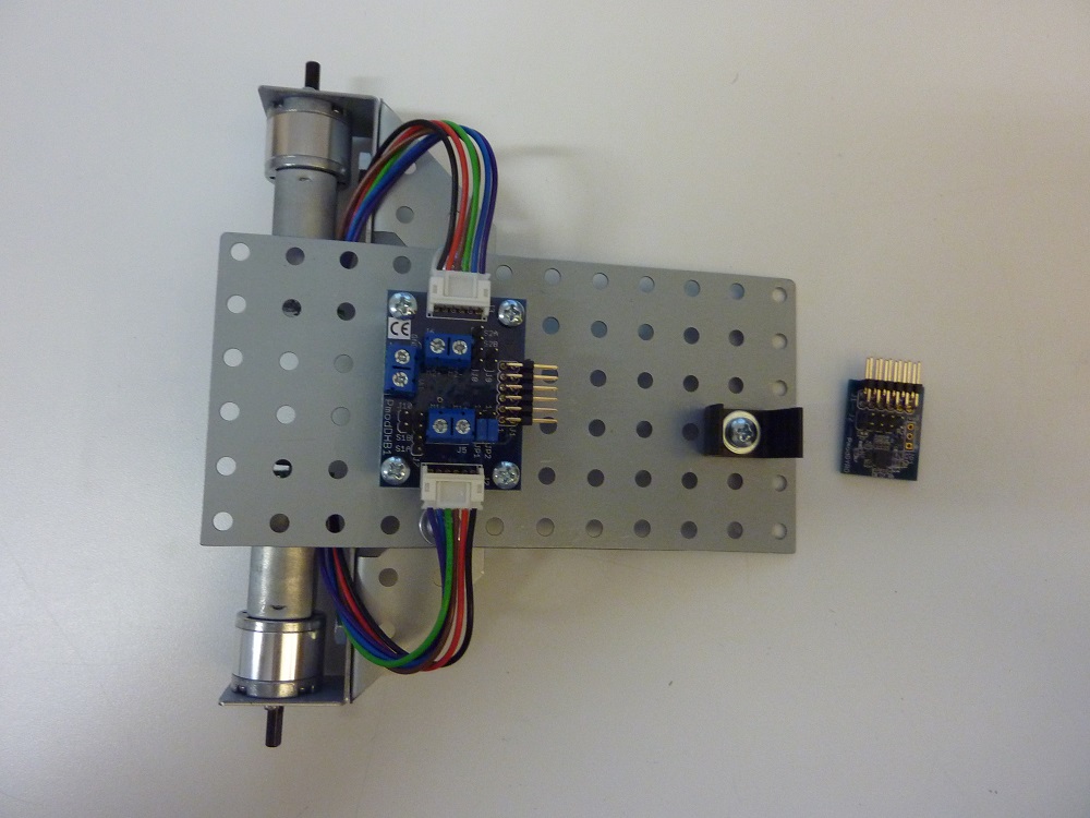

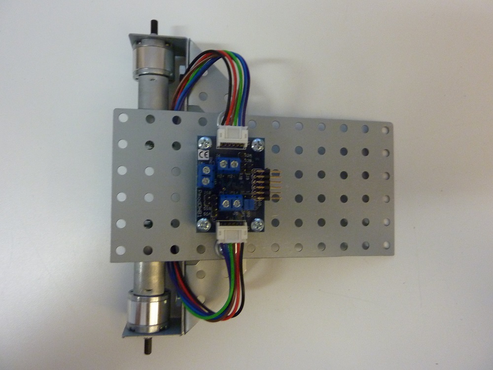

U-012: Build Prototype
myRIO Balancing Robot - Construction (1) klein.jpgmyRIO Balancing Robot - Construction (3) klein.jpgmyRIO Balancing Robot - Construction (4) klein.jpgmyRIO Balancing Robot - Construction (5) klein.jpgmyRIO Balancing Robot - Construction (6) klein.jpgmyRIO Balancing Robot - Construction (7) klein.jpgmyRIO Balancing Robot - Construction (8) klein.jpgmyRIO Balancing Robot - Construction (9) klein.jpgmyRIO Balancing Robot - Construction (11) klein.jpgmyRIO Balancing Robot - Construction (12) klein.jpgmyRIO Balancing Robot - Construction (13) klein.jpgmyRIO Balancing Robot - Construction (15) klein.jpg

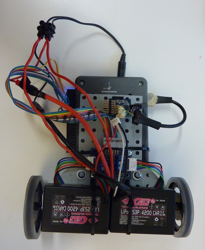

U-021: Electronics
Thanks to the choice of the Digilent Pmod Sensors and H-Bridge, no additional PCB is required for the myRIO Balancing Robot.
The only thing that must have been defined in U-021 was therefore the choice of the battery for the final version.
Tests have been made about the Power consumption of the motors and the myRIO.
It turned out, that the myRIO needs about 5W, the motors need between some and over 10 W (depending on the action)
A long time test with an Battery Pack (7.4V, 4200mAh, 31.08Wh) showed that the Prototype was running over 5h without the battery being totally empty. This means, the total system took around 6W.
For the final prototype a Battery of 11.1V, 1300mAh, 14.43Wh has been chosen. The estimate is, that the myBOT can run on this battery for 2-3h.
